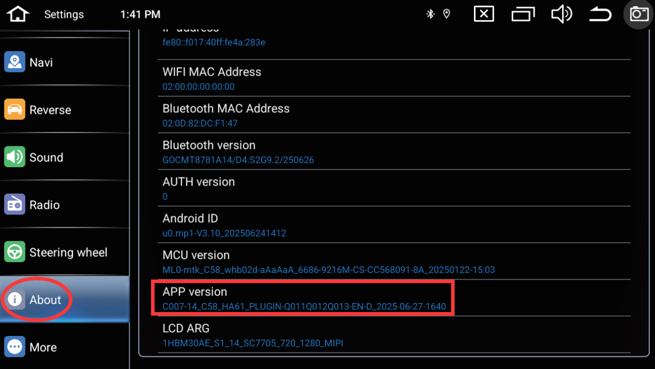

  • @Spencer
    In order to help you better, please provide below APP version picture to our email address and indicate your Order ID# in email subject.
    Thanks in advance.
    Email: office@roadanvi.com
    Go: Settings > About > APP version
