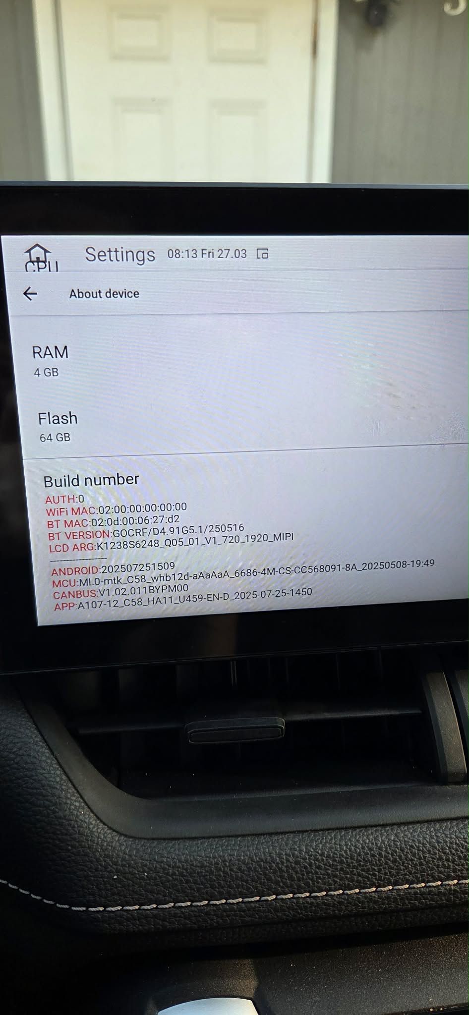

  • When i am using android auto and on call the bluetooth will disconnect every 13 minutes. I have attached my build info
  • @matt breaux
