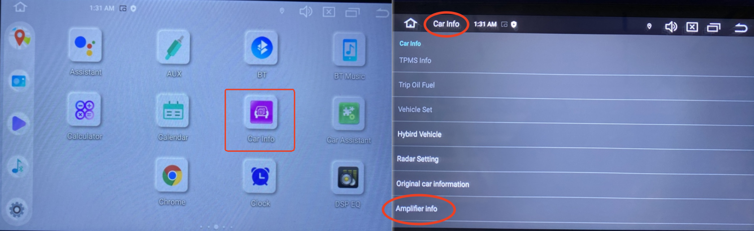

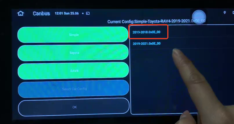

    Settings>Car Settings>Factory Settings(0000)>Can Settings>Modify>Simple>Toyota
    And please go to the Car info app to adjust the factory amplifier.
