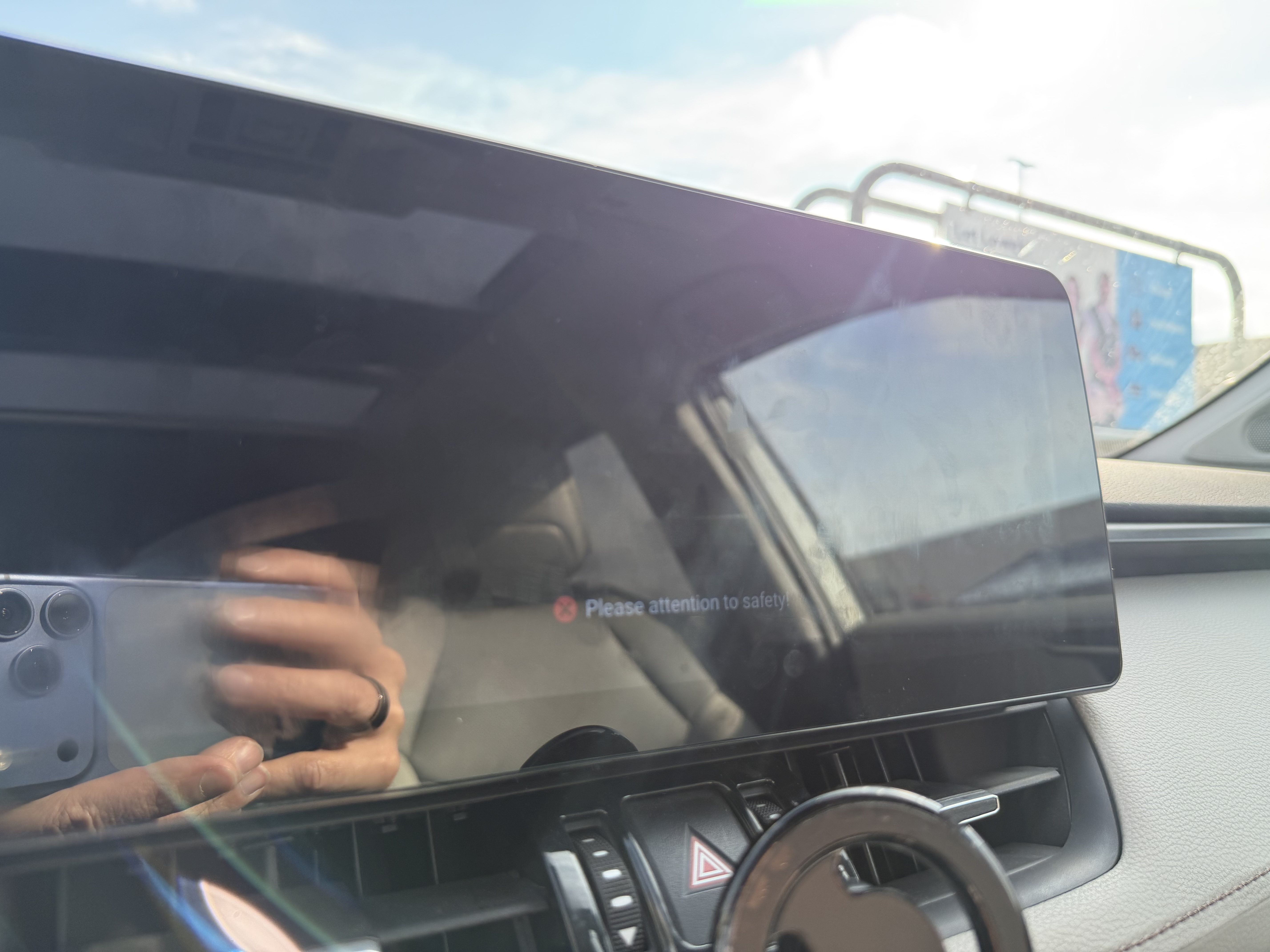

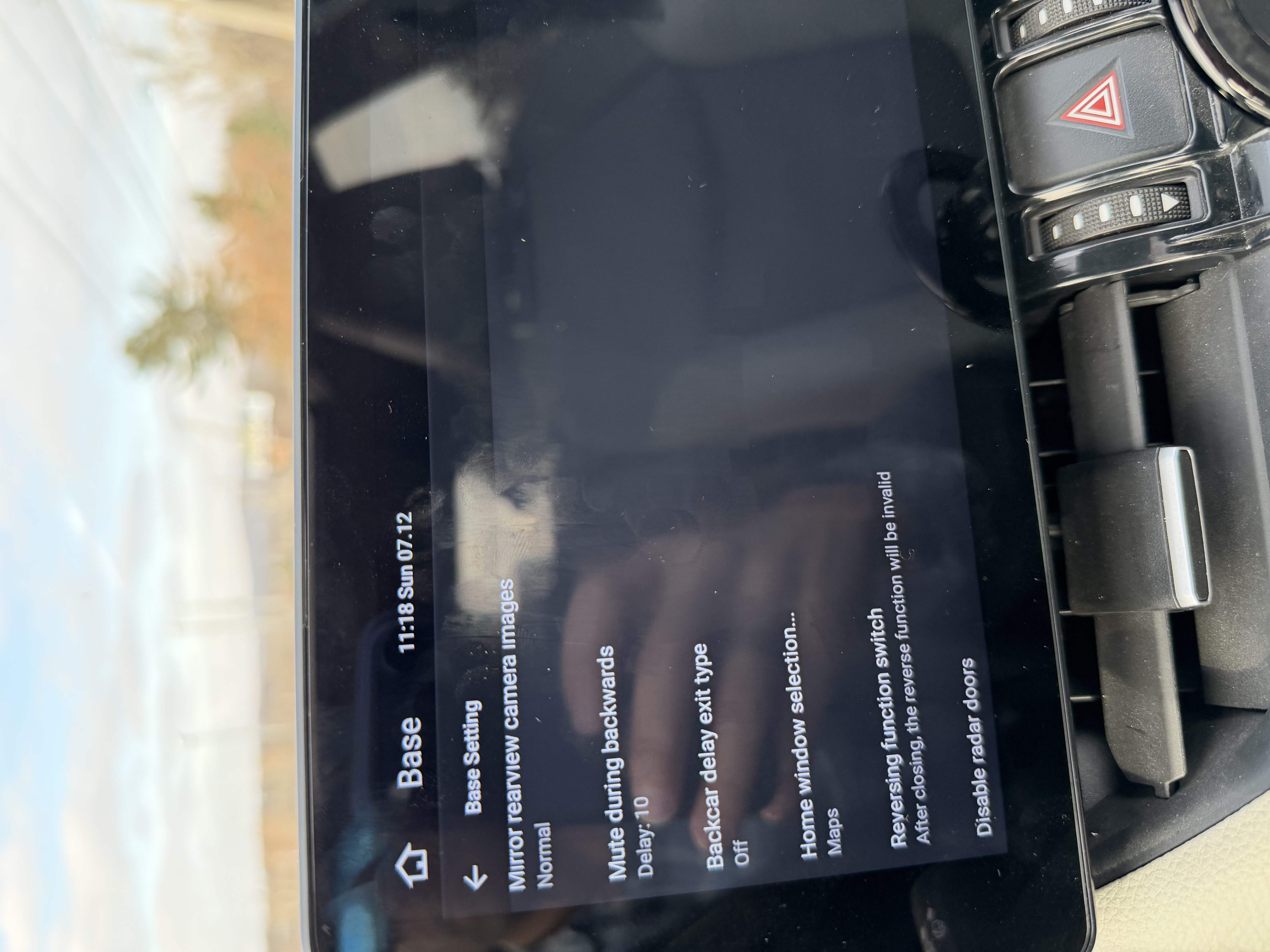

  • @Roadanvi Support apologies for the delay, I don't drive often. Here are the photos
    when fhe front camera should show:
    while in reverse:
    While in reverse

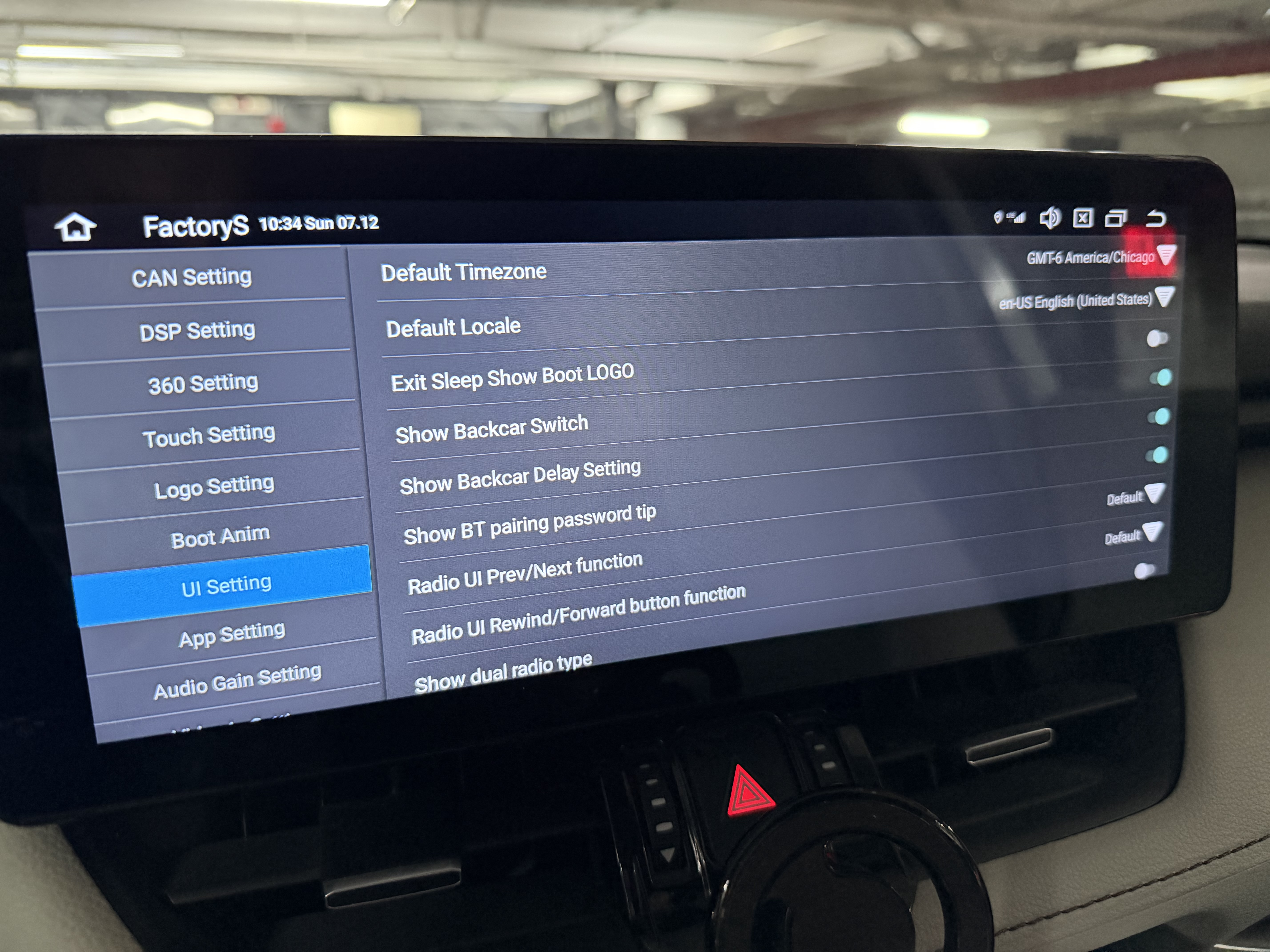

    Please try to do as follows:
    Step1.
    Go Settings > More > Factory Setting(password: 0000) > Reverse > Show Backer Delay Setting > On > Exit and Reboot.
    Step2
    Go Settings > Reverse > Back car delay exit type > Off  > Exit and Reboot.

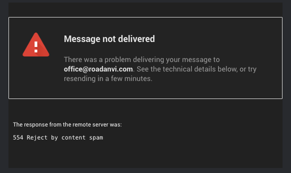

  • Sill doesn't work, I'll send an email
  • Your system is rejecting my email
    Can you DM me here?
  • @Matt Coneybeare Yes,we are currently receiving emails from other guests.I will send message to your email.
