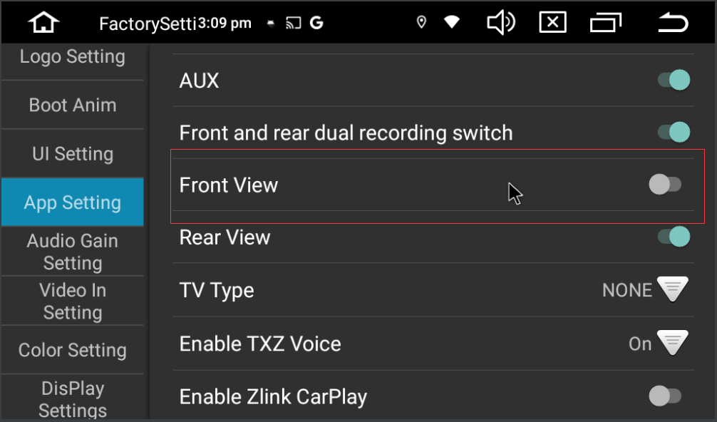

  • Hi there,
    Please go to the setting:
    Settings>Car Settings>Factory Settings(0000)>App Settings>Front veiw>OFF
