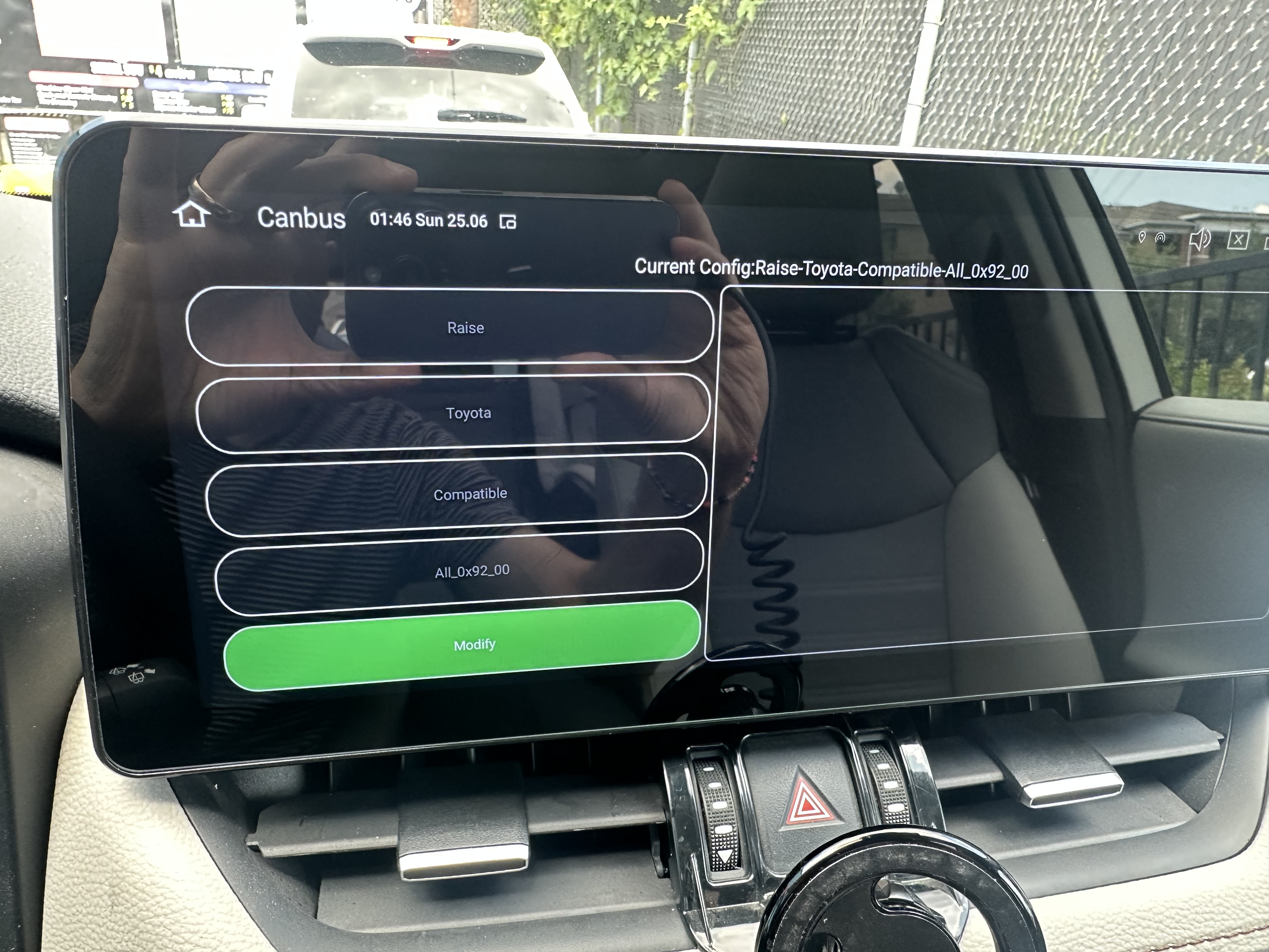

I have also had problems with the steering wheel audio forward and reverse buttons being reversed. I am currently using Canbus settings Raise > Toyota > Compatible > All_0x92_00 as this is the one I could find that allows for siri to be triggered with the steering wheel button.

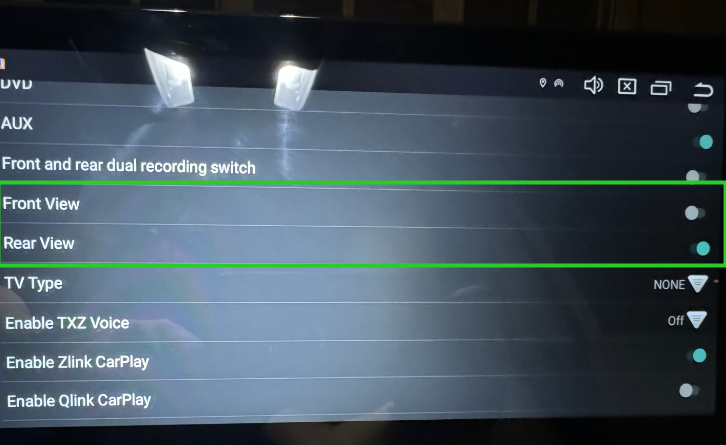

Just need to connected the CAMIN cable to the camera cable is ok.
Settings>Car Settings>Factory Settings(0000)>App Settings>Rear view>ON>Front veiw>OFF
Ok, I will try that software toggle. What about the reversed buttons and canbus setting?
@Matt ConeybeareRegarding the issue of steering wheel audio forward and reverse buttons being reversed,please go Settings>Car Settings>Factory Settings(0000)>Can Settings>Up and Down Swap Switch

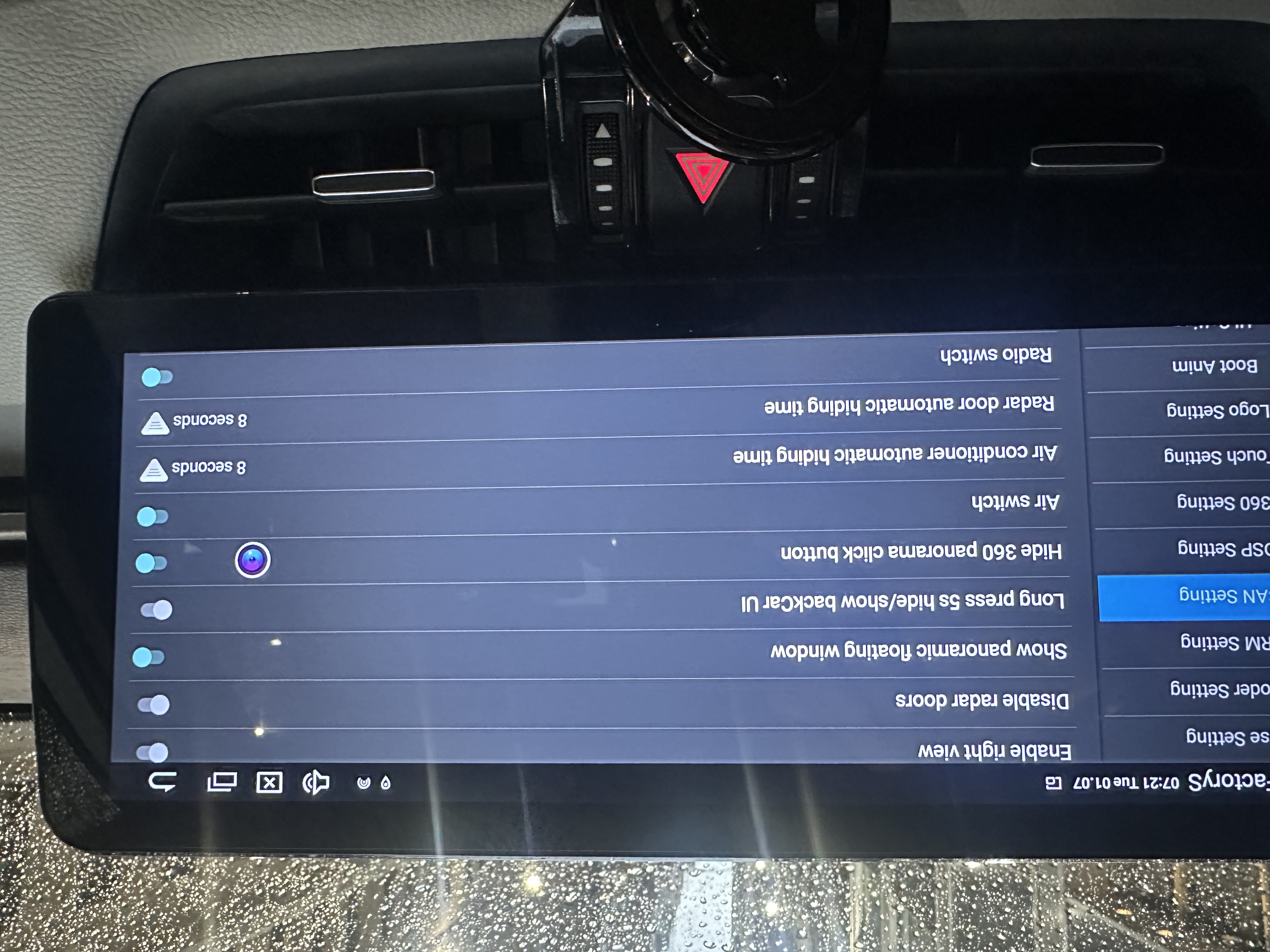

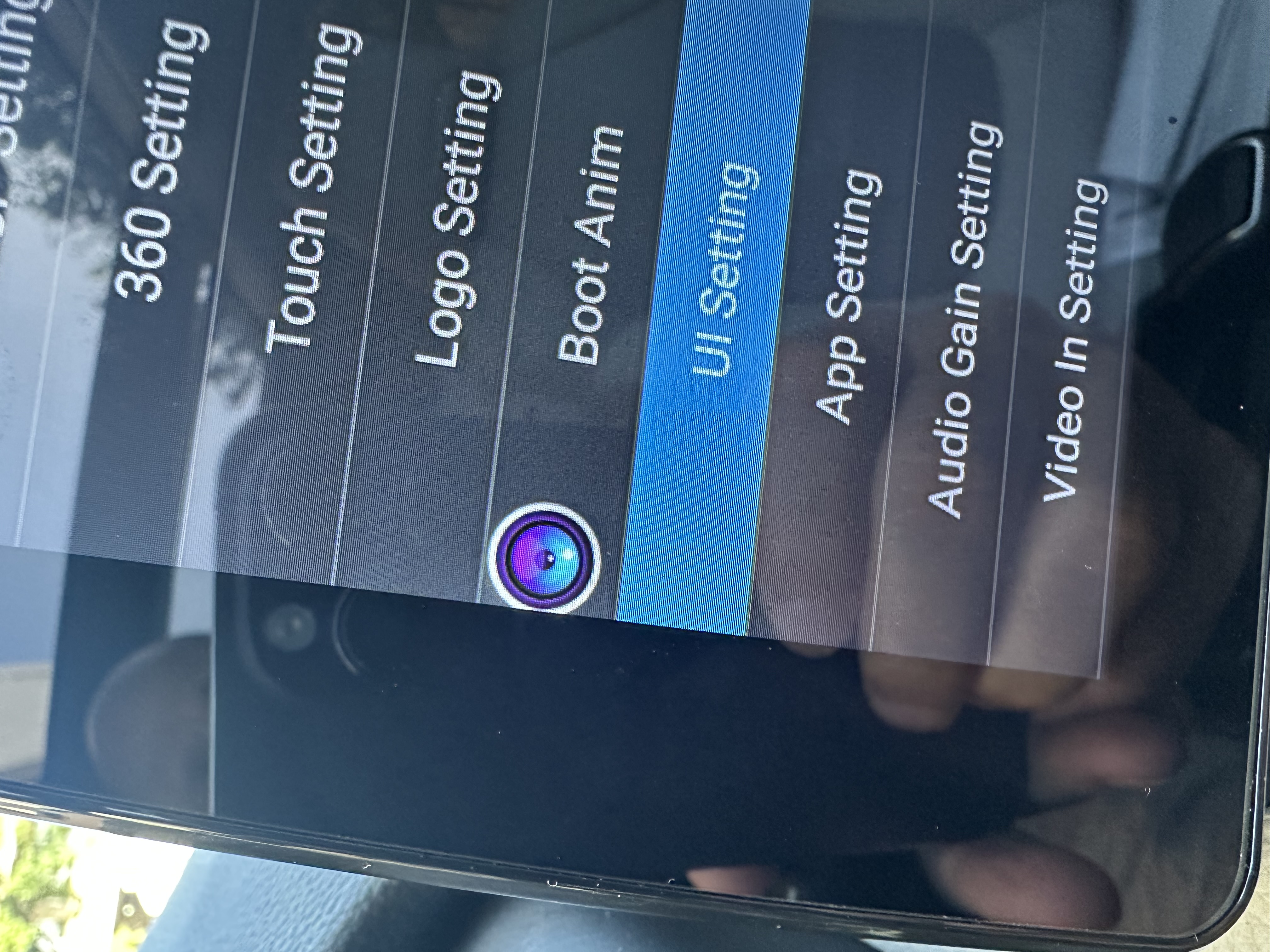

thanks! Last question, how can I disable this floating camera icon? It doesn't do anything and I can't find what setting turns it off
@Matt Coneybeare

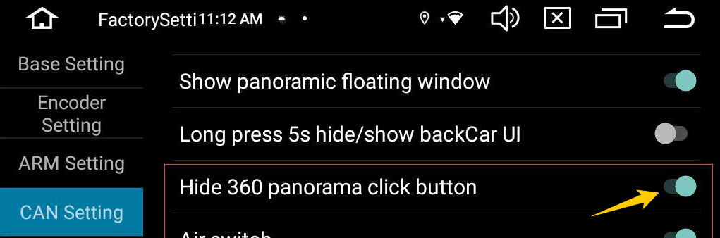

Settings>Car Settings>Factory Settings(0000)>Can >disable the setting of 360 button
Unfortunately that did not hide it, even after restarting
@Matt Coneybeare

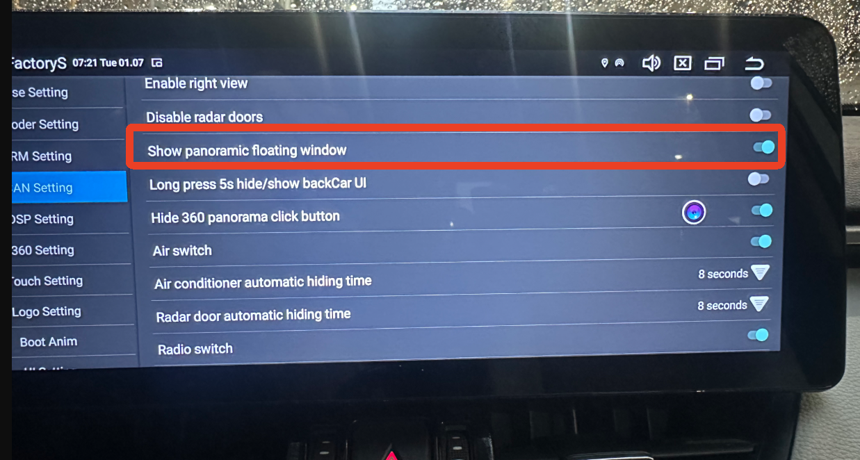

Hello,
Please go Settings>Car Settings>Factory Settings(0000)>Can Settings>Show panoramic floating window>OFF
I don't see the option for front view and rear view
@Carl Miner
Hello,
Thank you for your contact.
May we have your order ID and special year for your car?
Since it is controlled by the Canbus, it only show on that car.
