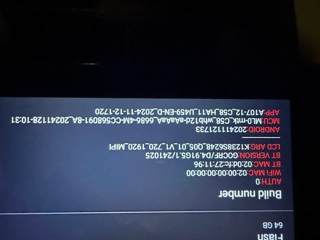

In order to help you better, please provide the following information:
1.
Order Number & Purchase Date.
2.
Please go Settings > About device > Build number(MCU, APP),
then send its photo to us.
Thank you. The order was placed on Amazon on June 2nd, 2025. Order number: 113-5611542-3554644
Here is a picture of the Build number(MCU, APP)
@LEONARDO CHAVEZ Hi Leonardo,
We just sent the a system update file to your email,please kindly check it.
