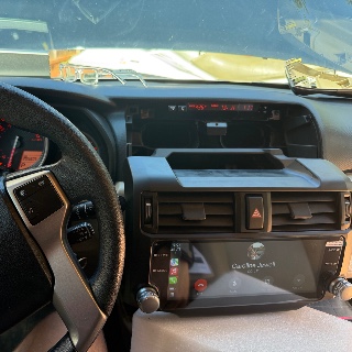

I am going to connect an external amplifier to my X12 for my subwoofer but I don´t know which cable to connect to the remote input of the amp. Is it number 13, amp, on the K connector?
And is there any settings in the software i must adjust for the remote signal to work ones I have connected everything?
